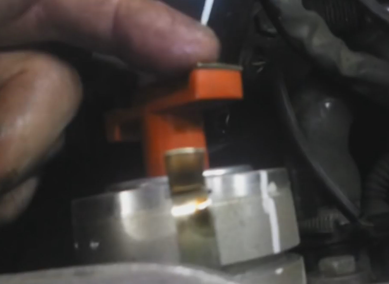

Сообщение jhm »
Mark case next to 1-st cylinder spark cable

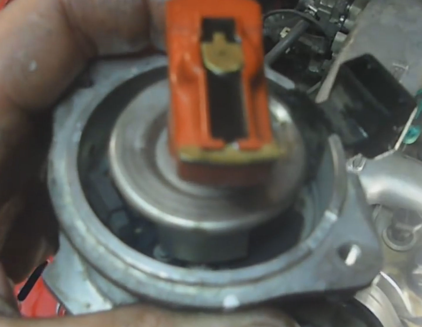

Сообщение jhm »
Remove distributor cap and turn crankshaft to align rotor with your mark

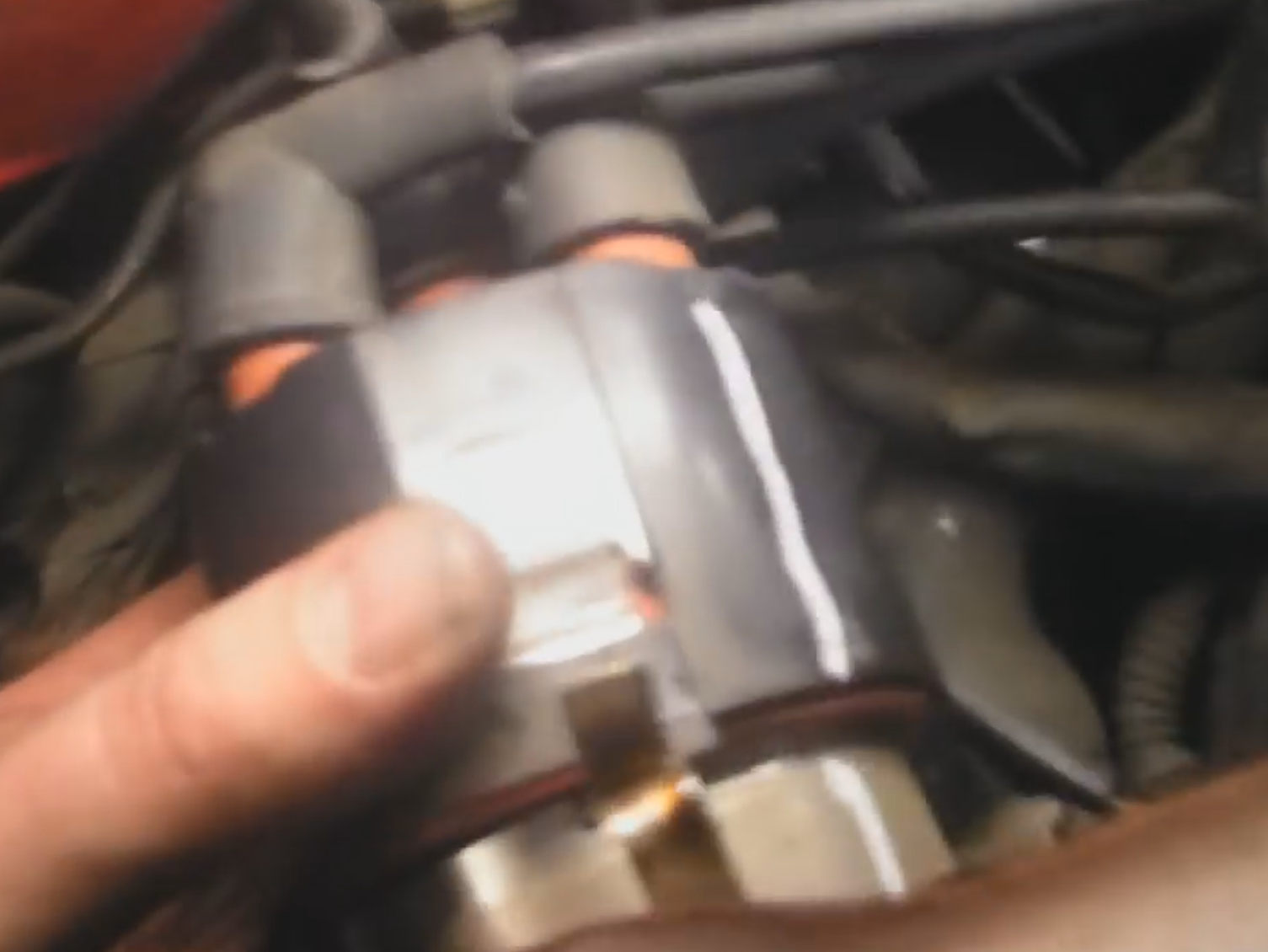

Сообщение jhm »
Remove distributor. Keep rotor aligned to mark

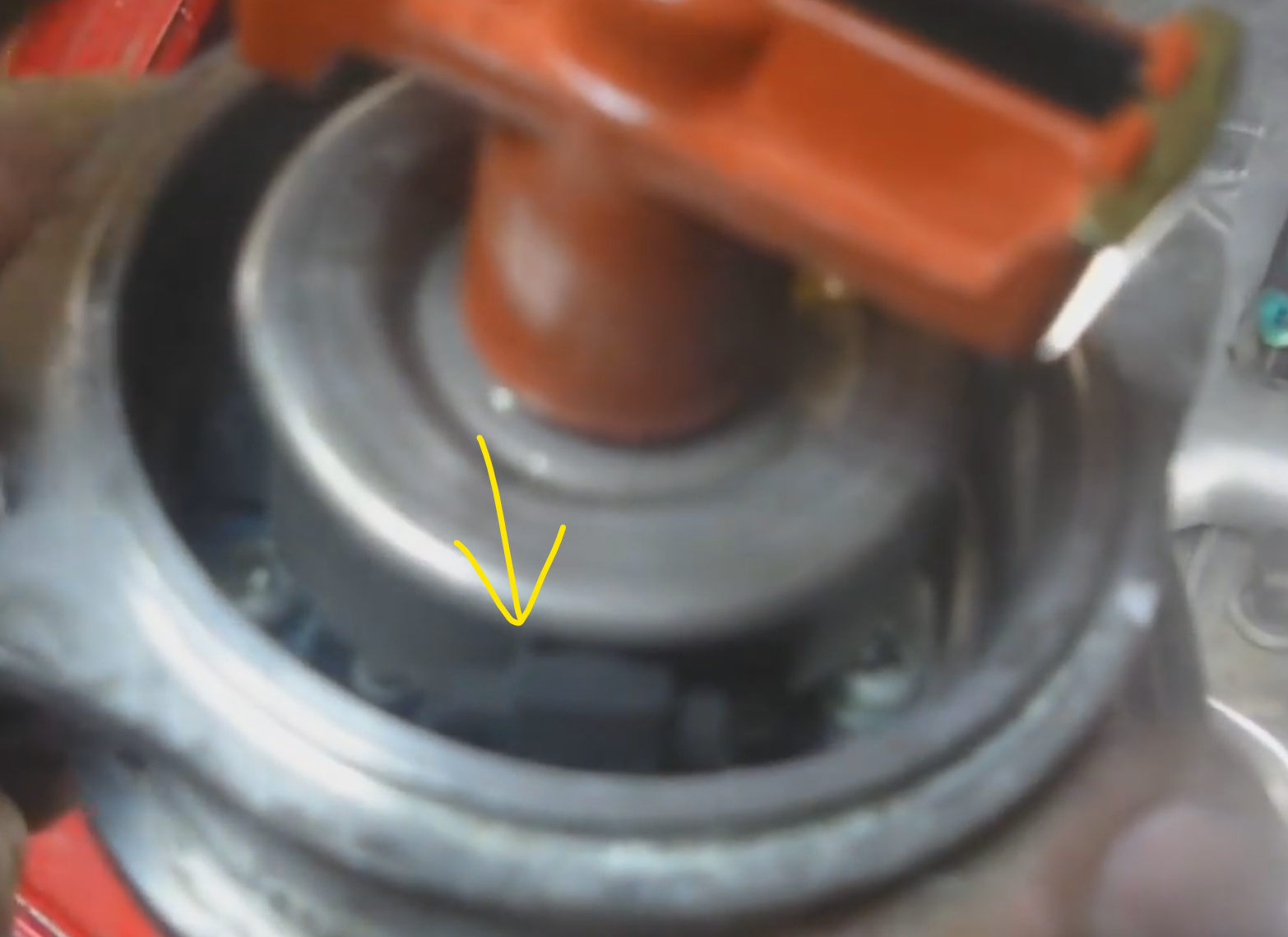

Сообщение jhm »
Mark distributor vane, which is at the center of the hall sensor. This vane should be cut by 1.1mm

Сообщение OldSamuray »
Do not forget, on the ACE motor the rotor rotates counterclockwise
