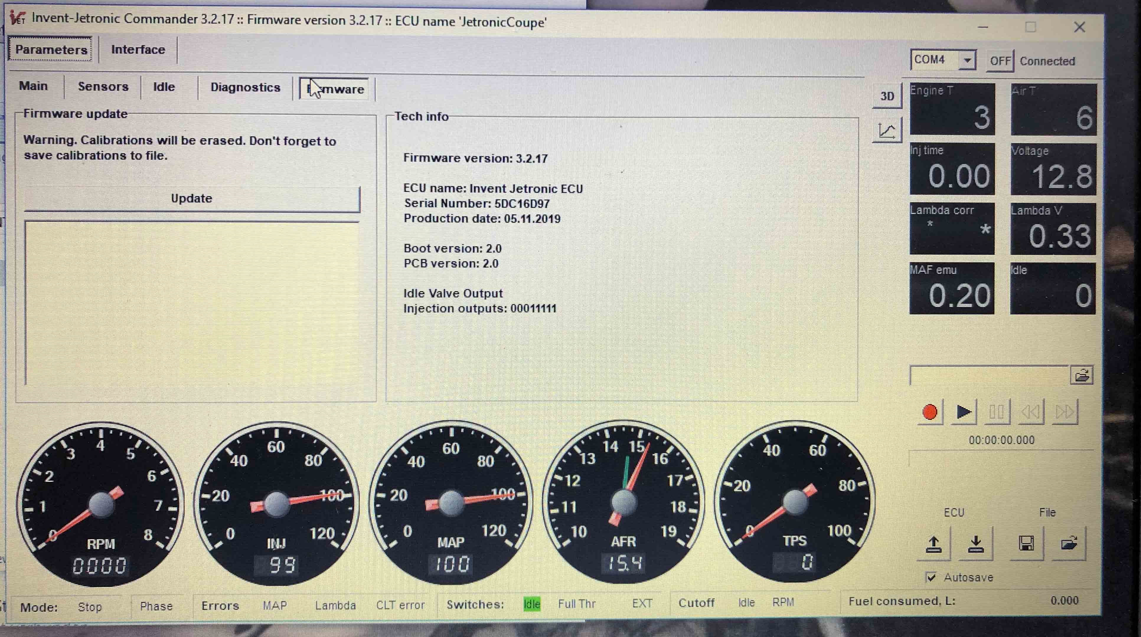

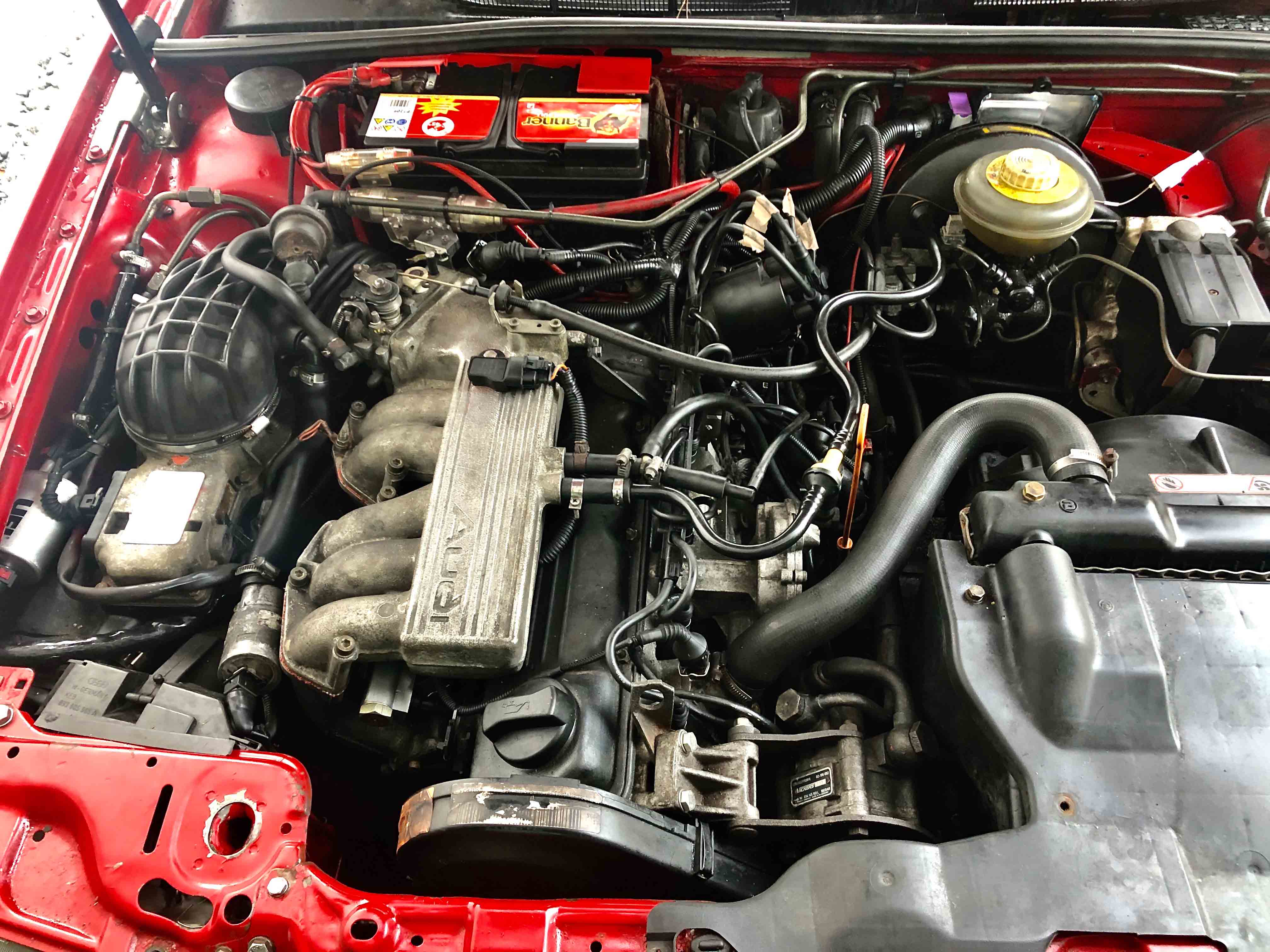

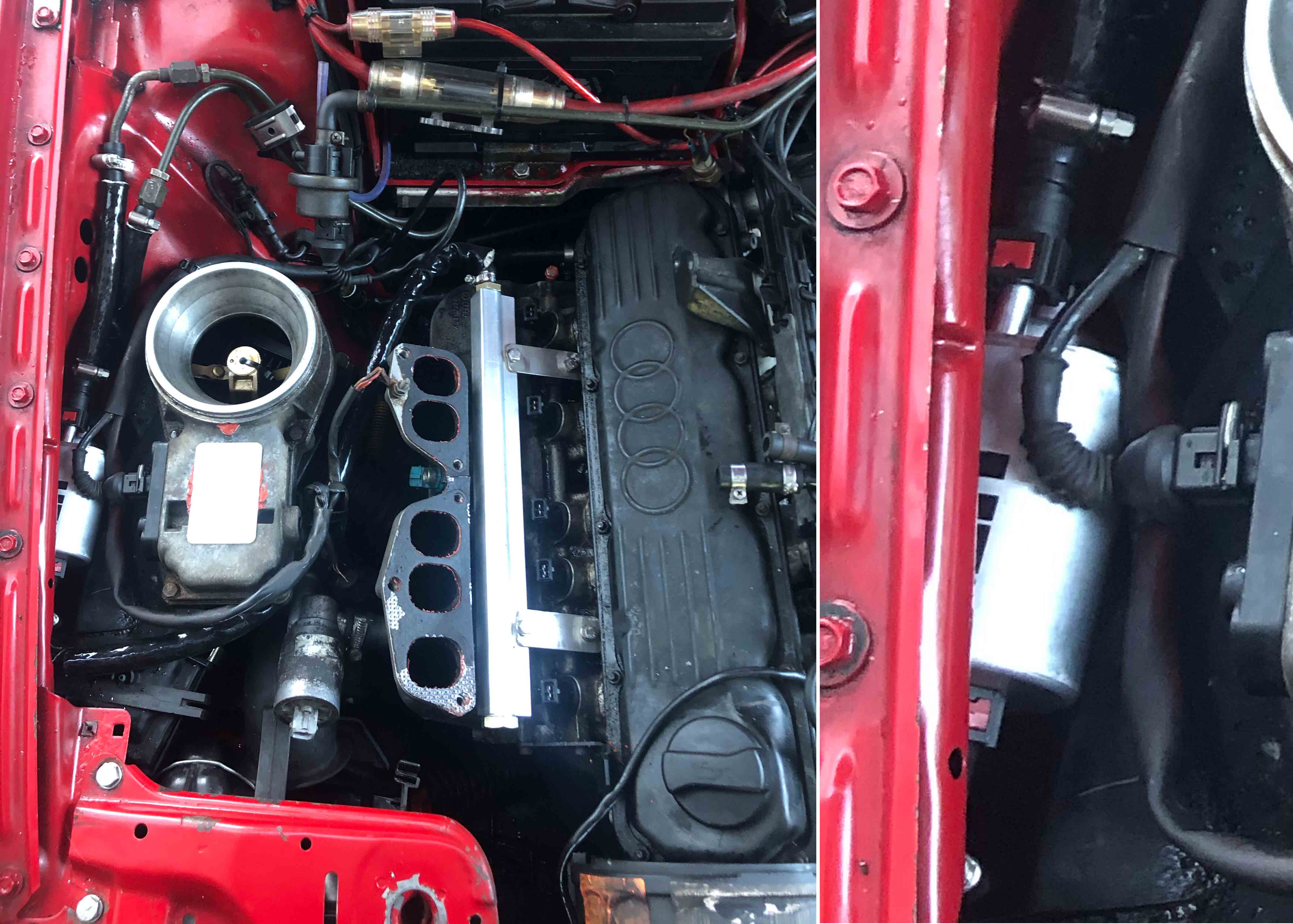

I do a lot on my Car by myself, I put in a new Engine (also NG) and it was working good before I installed Invent Jetronic.

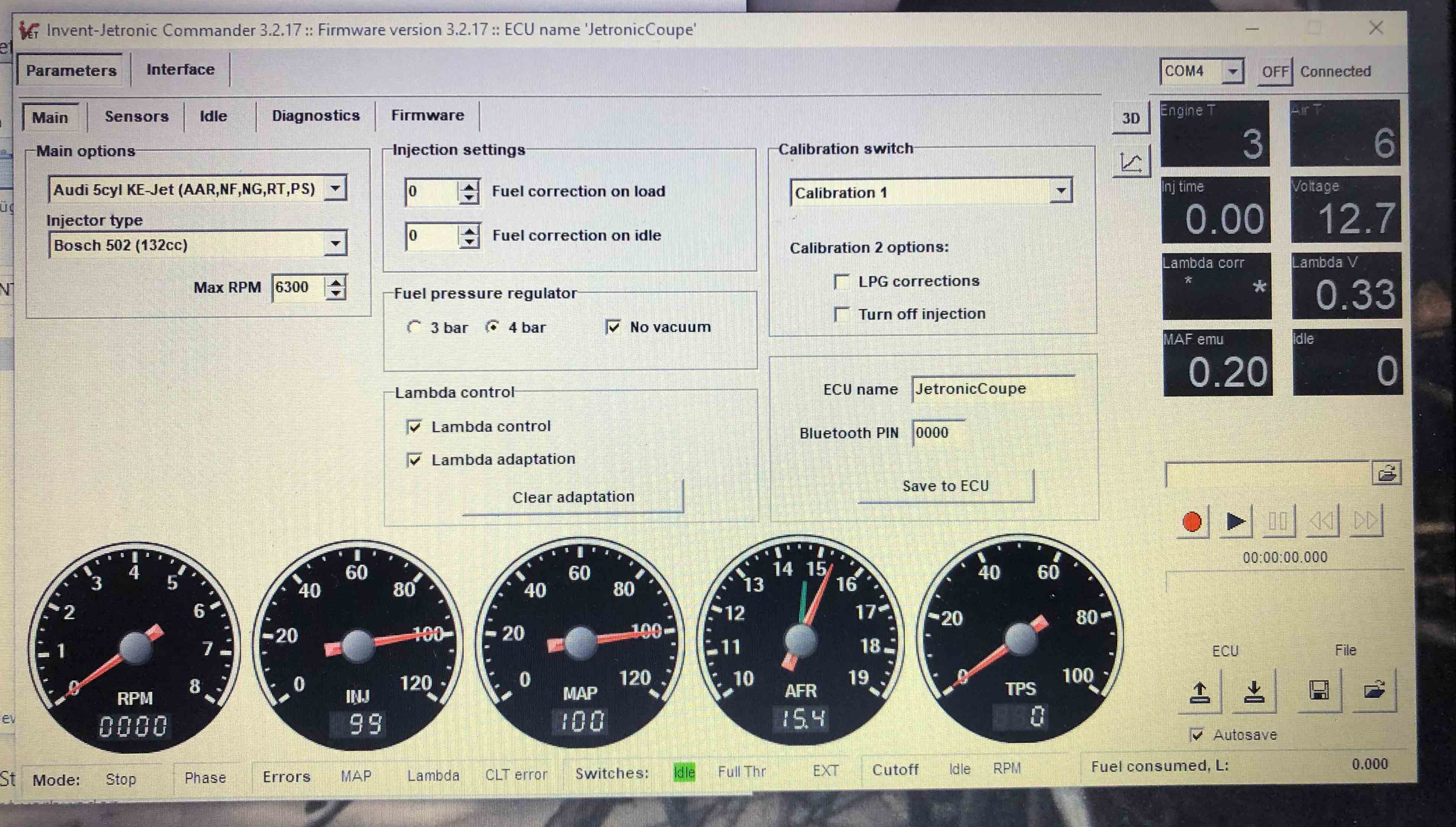

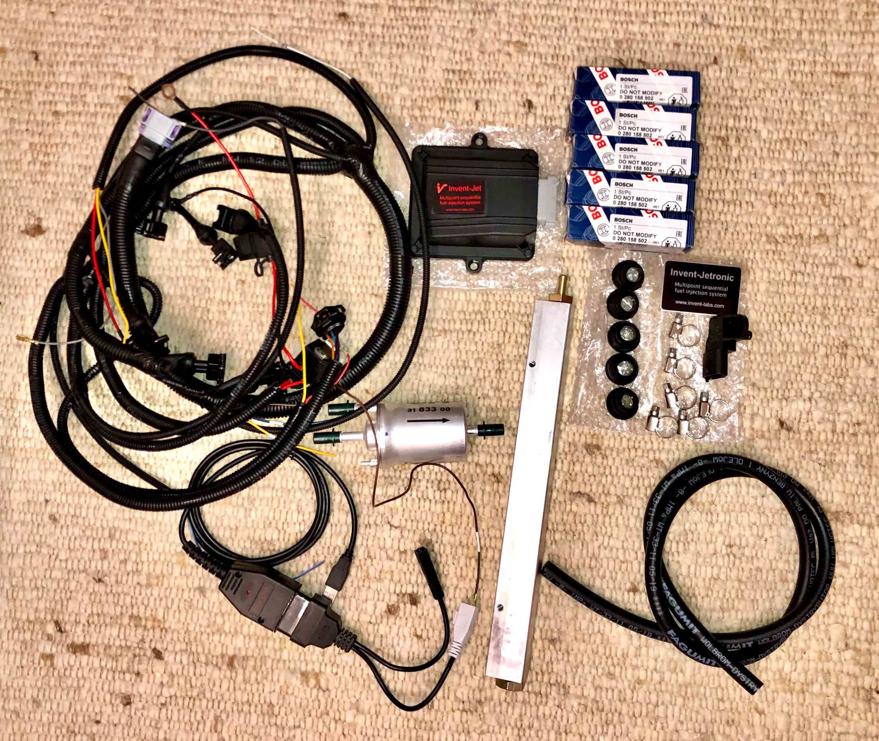

I installed the Invent Jetronic and loadet the newest firmware and Calibration (3.2.17) off the Forum.

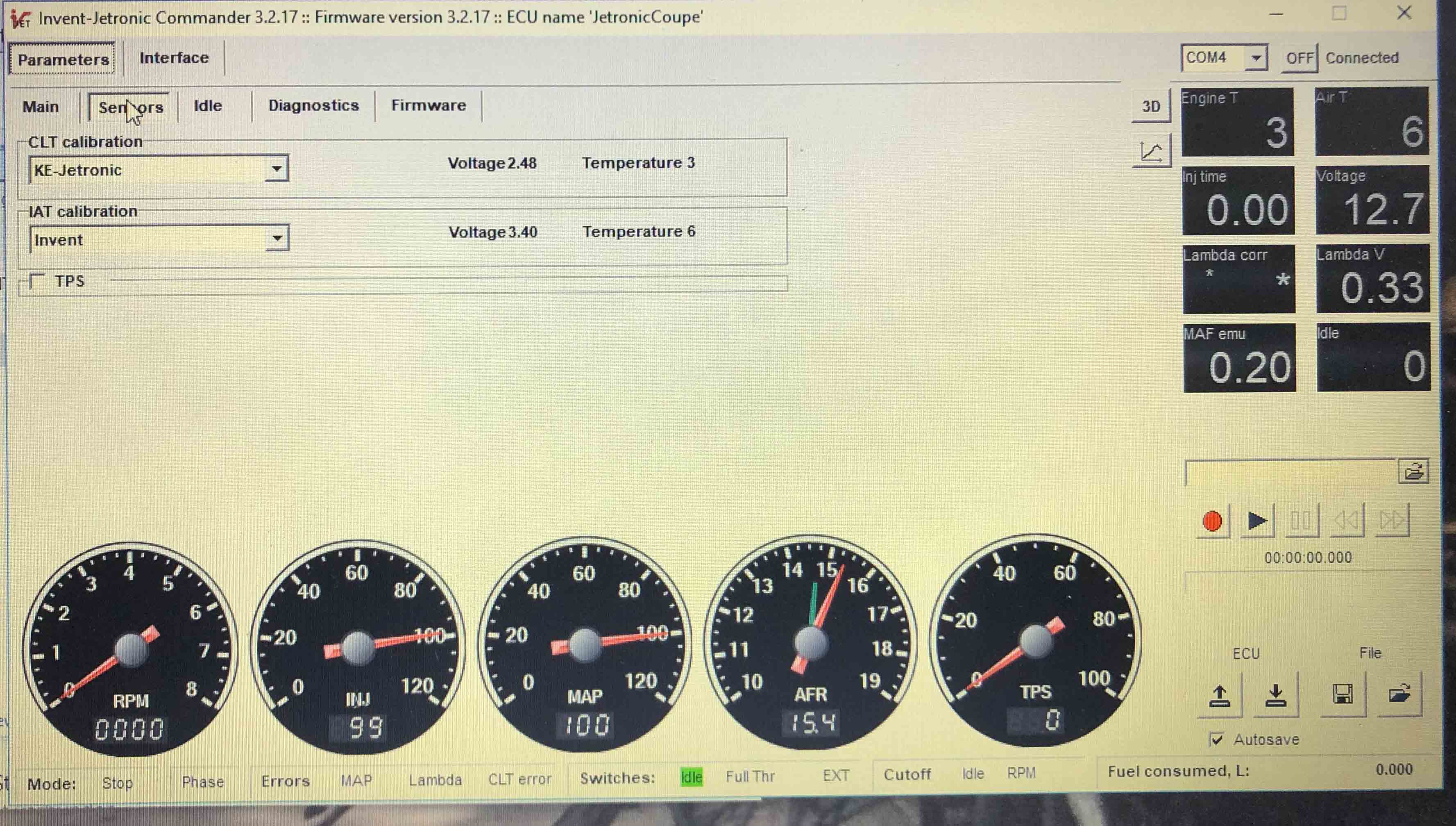

1. My K-Full and K-idle wires are connected correctly.

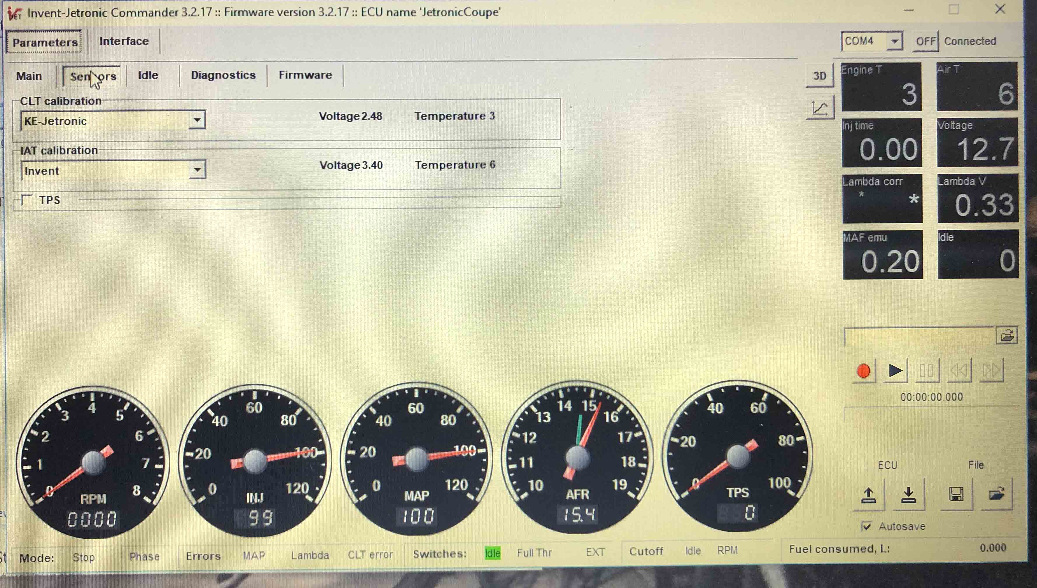

2. My Map Sensor Temperature and Engine Temperature Show a difference of 3 degree (3 and 6 degree) so I think they work also.
3. I cut off the middle wire on the Jetronic wire and connected EMUL.
4. Lamda is conected (but is not important for starting)

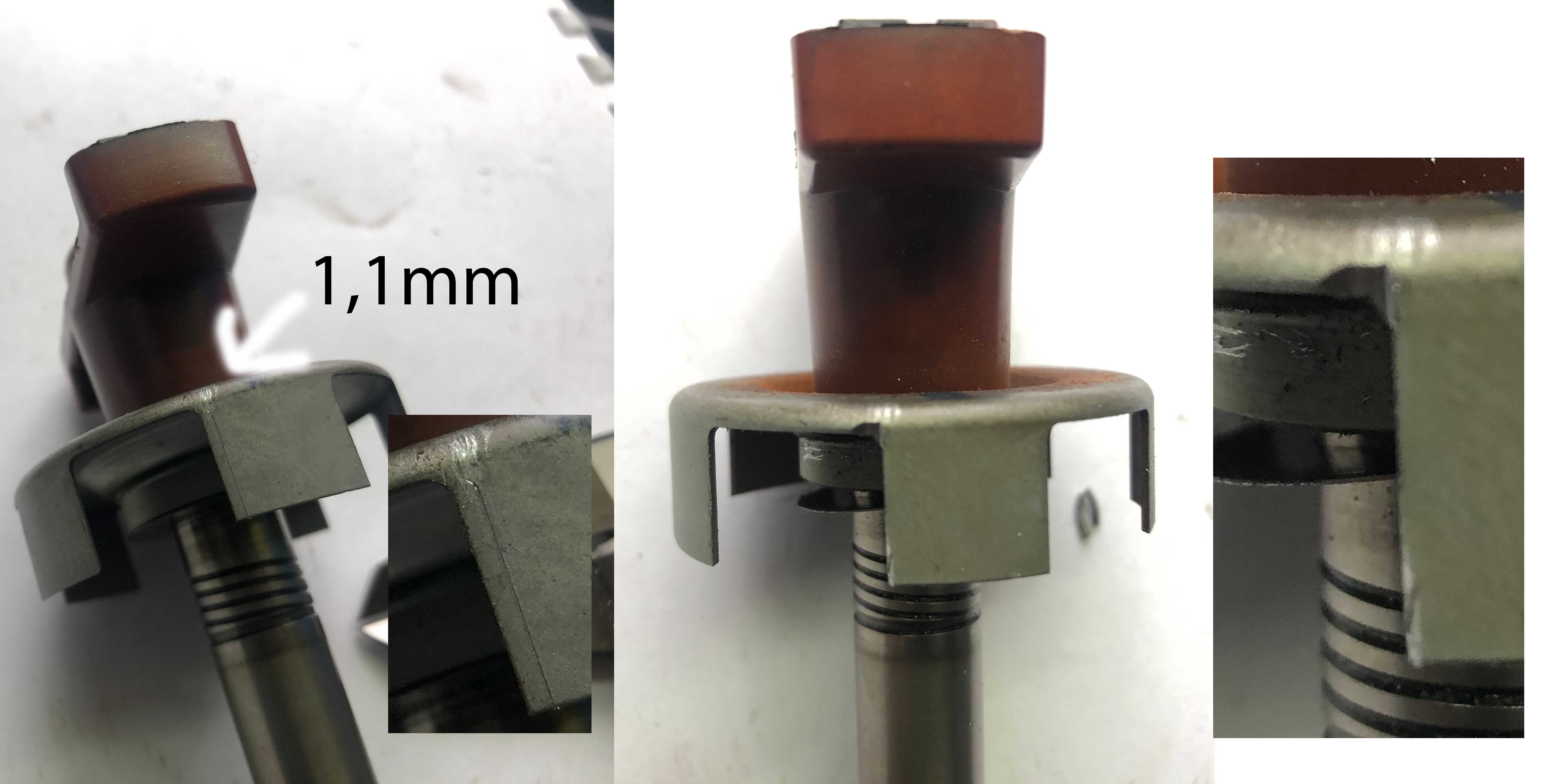

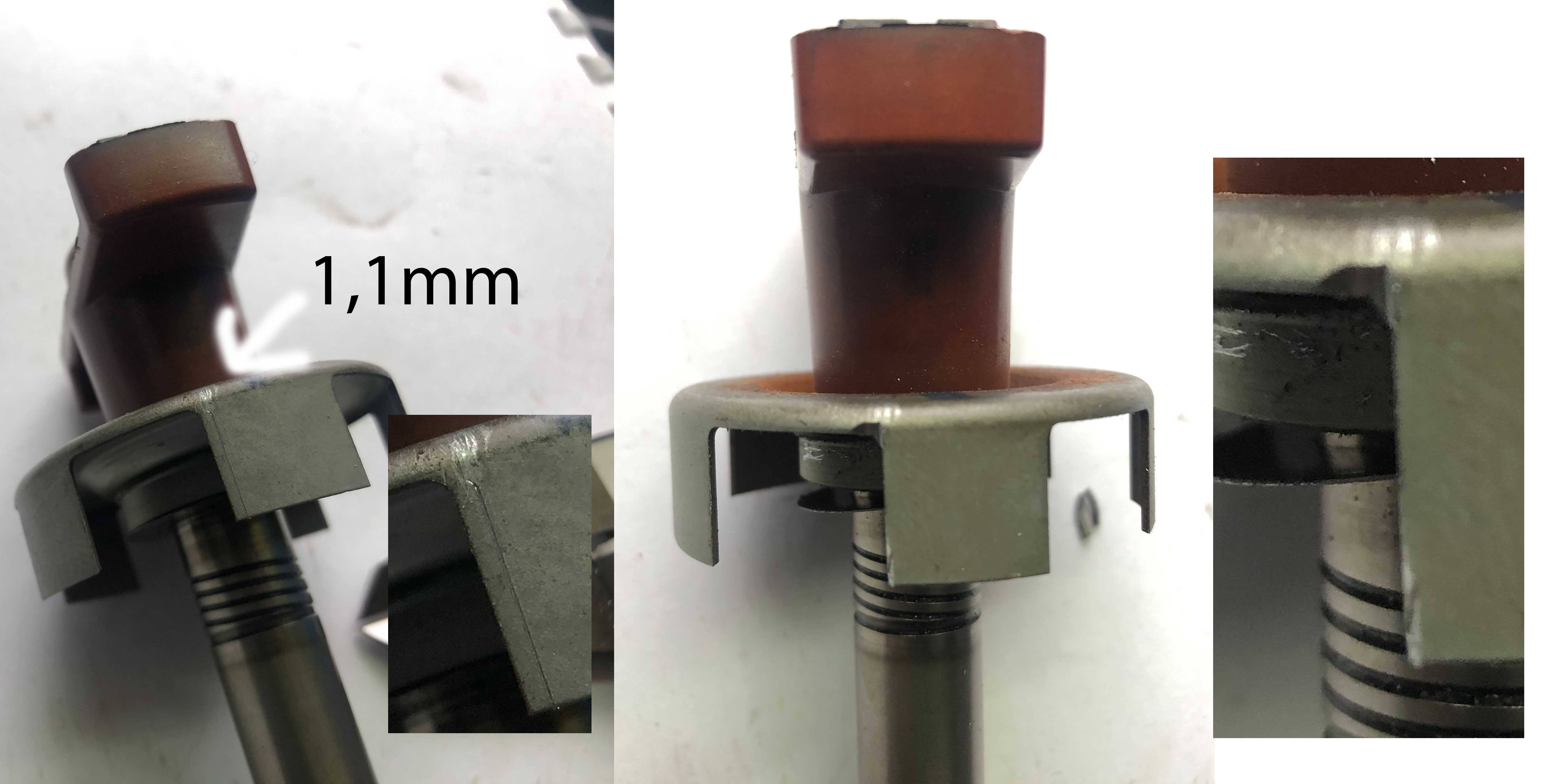

5. I connected “DH” in a parallel to the middle pin of the hall-sensor and I enlarged the Window by 1.1mm
6. I tested the 5 Injectors and they clicked.
7. I tested Spark of the first Cylinder and the spark plug is working
8. Fuel Pump is working and Fuel is coming out the Fuel Rail if I remove a Injector.

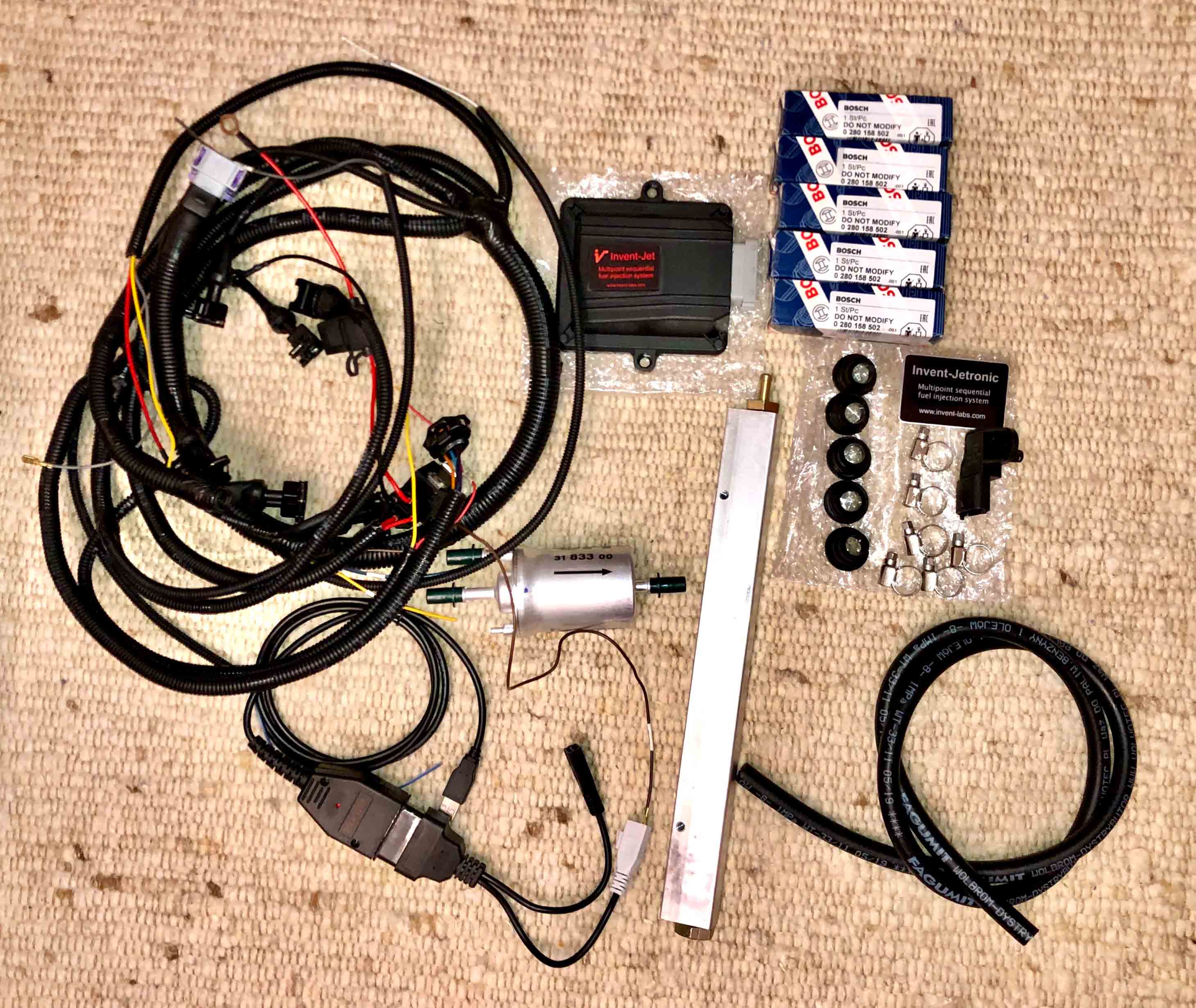

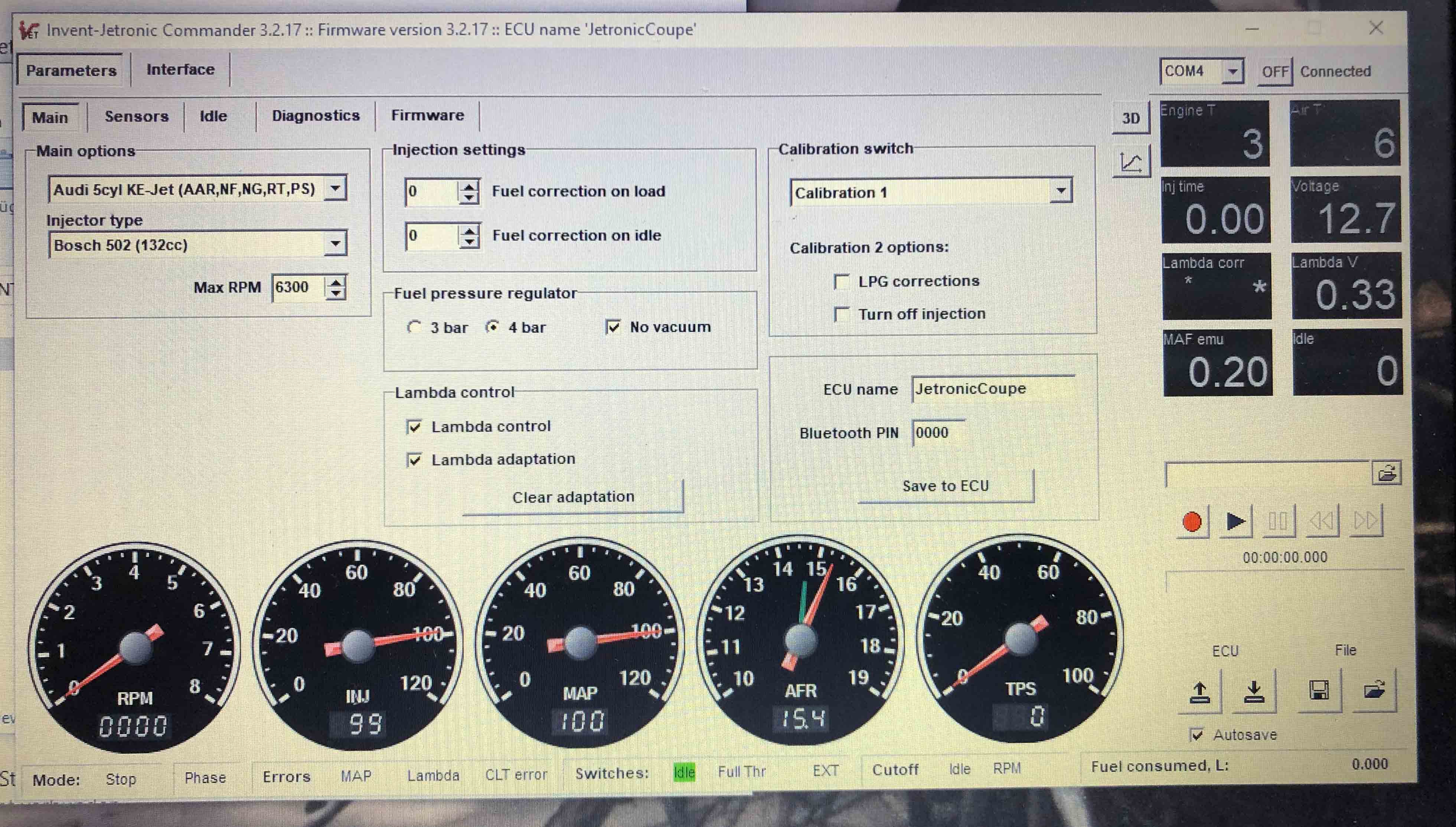

9.I had Bosch 0 280 158 502 Injectors in my Kit and Selected them in the Commander.
10. My Fuel Pressure Regulator is 4 Bar UFI 31 833 00
-> Spark plugs are dry after Starting attempt so I think the Engine does not get any Fuel?
What could be the problem?

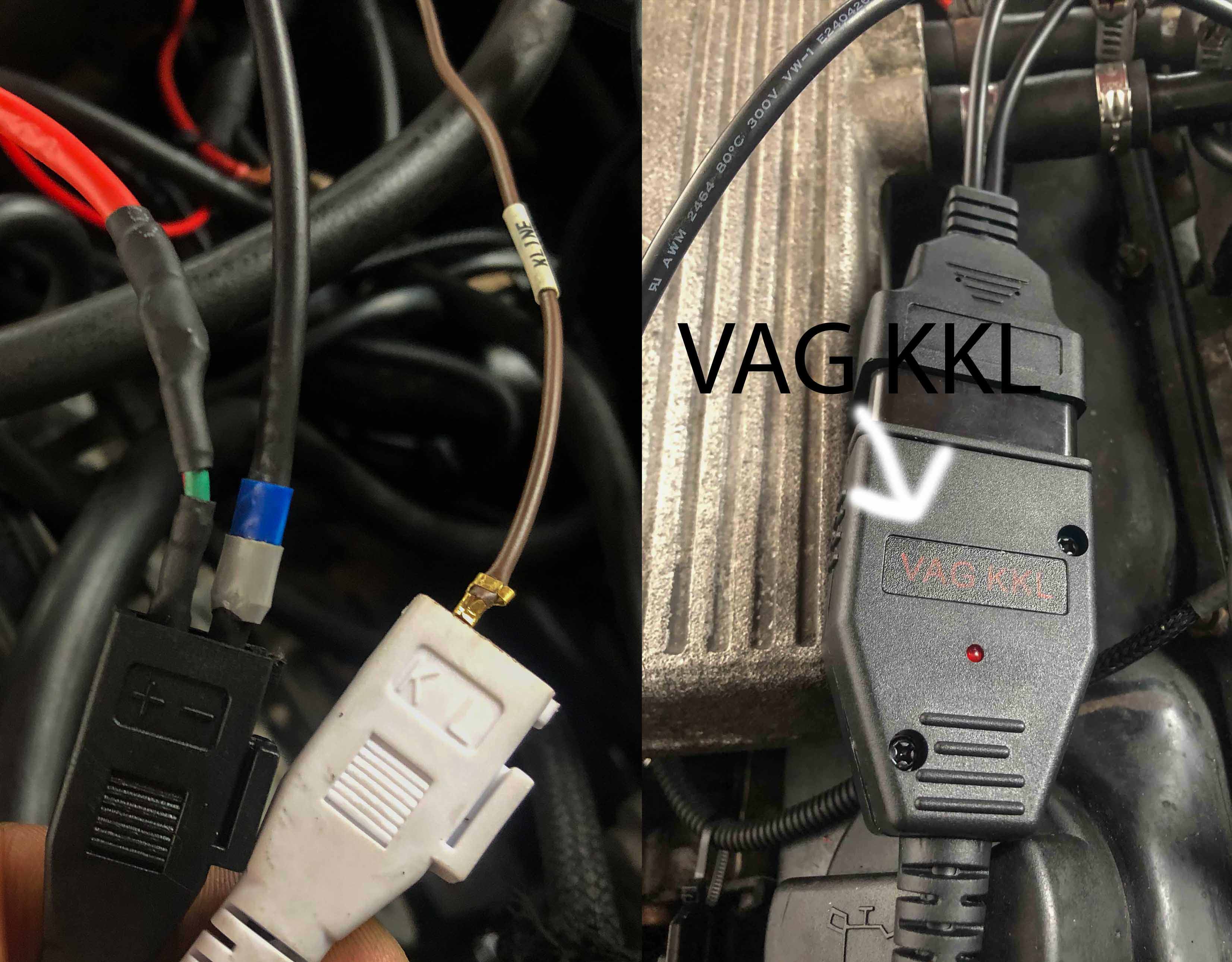

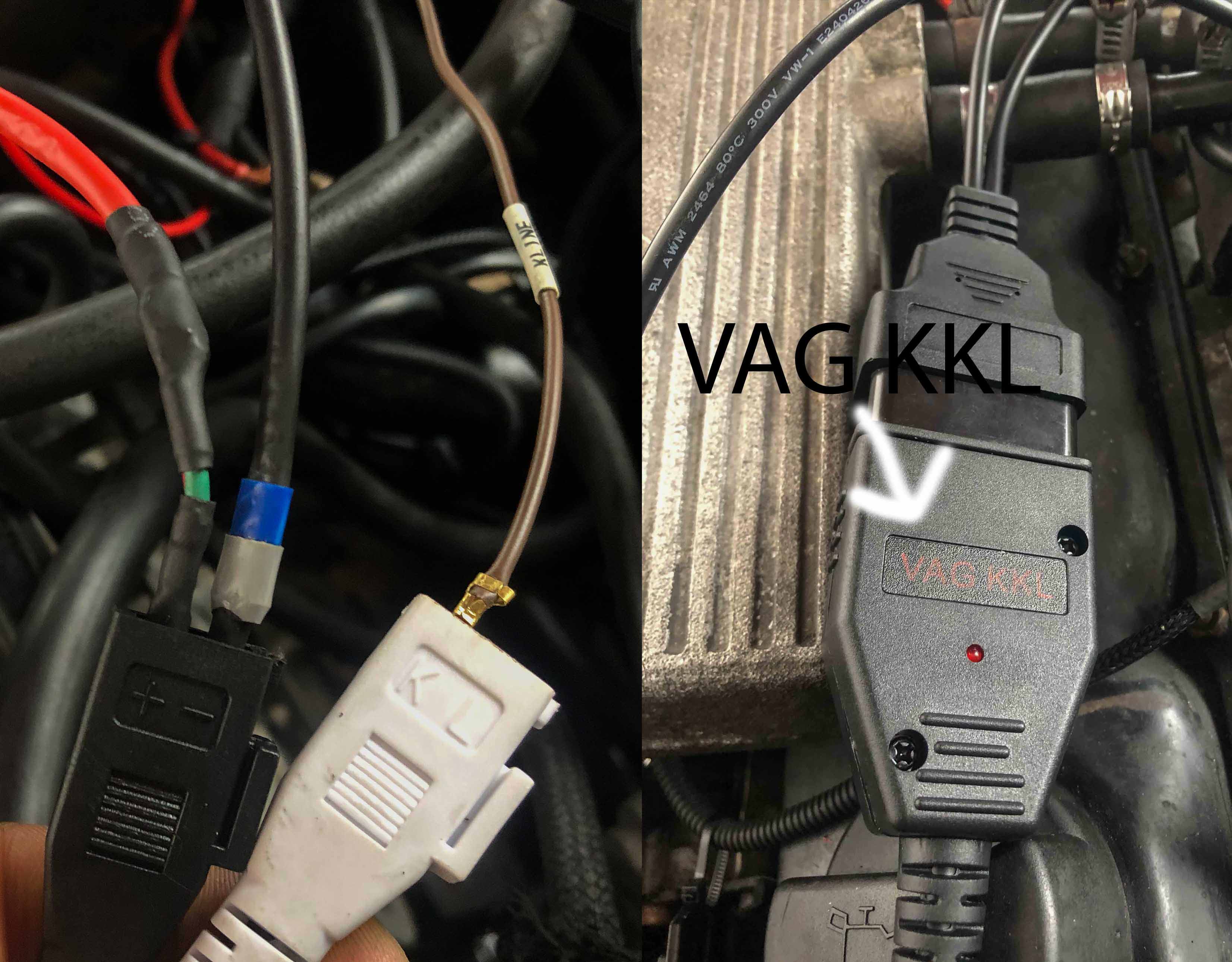

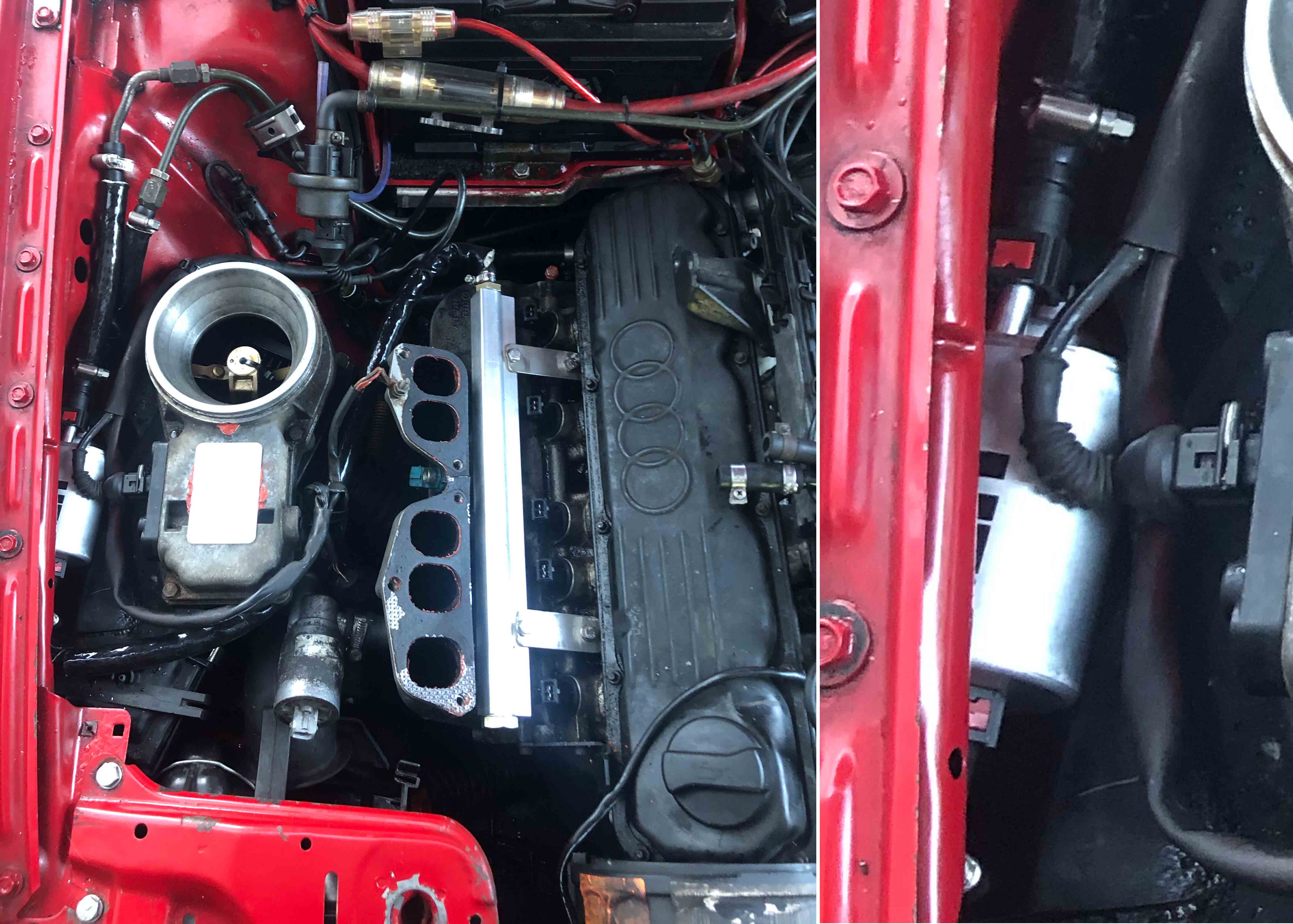

Ja patkluschajus masgam Bluetooth, u mina Kabel (OBD - USB) ni rabotajit posmatriti foto esli eta prawilno.
Nada Programmu na etat Kabel?

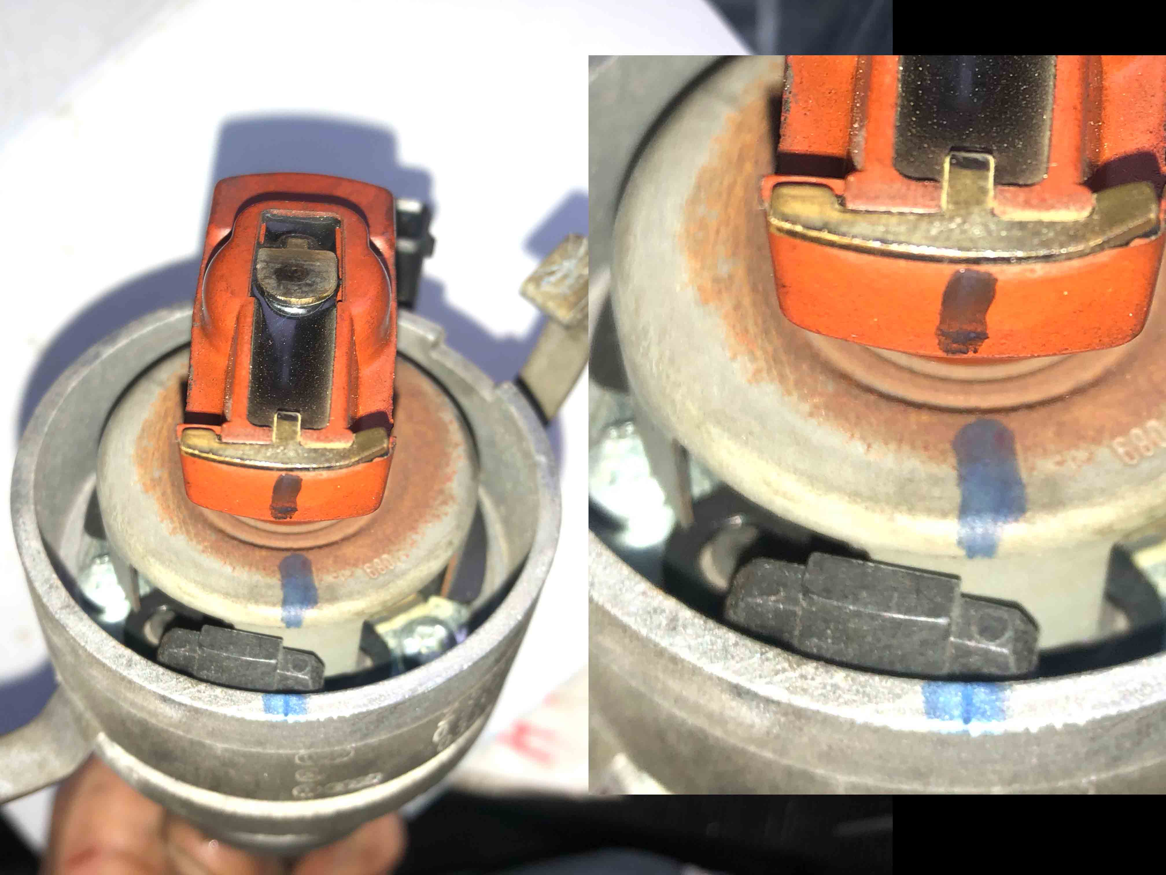

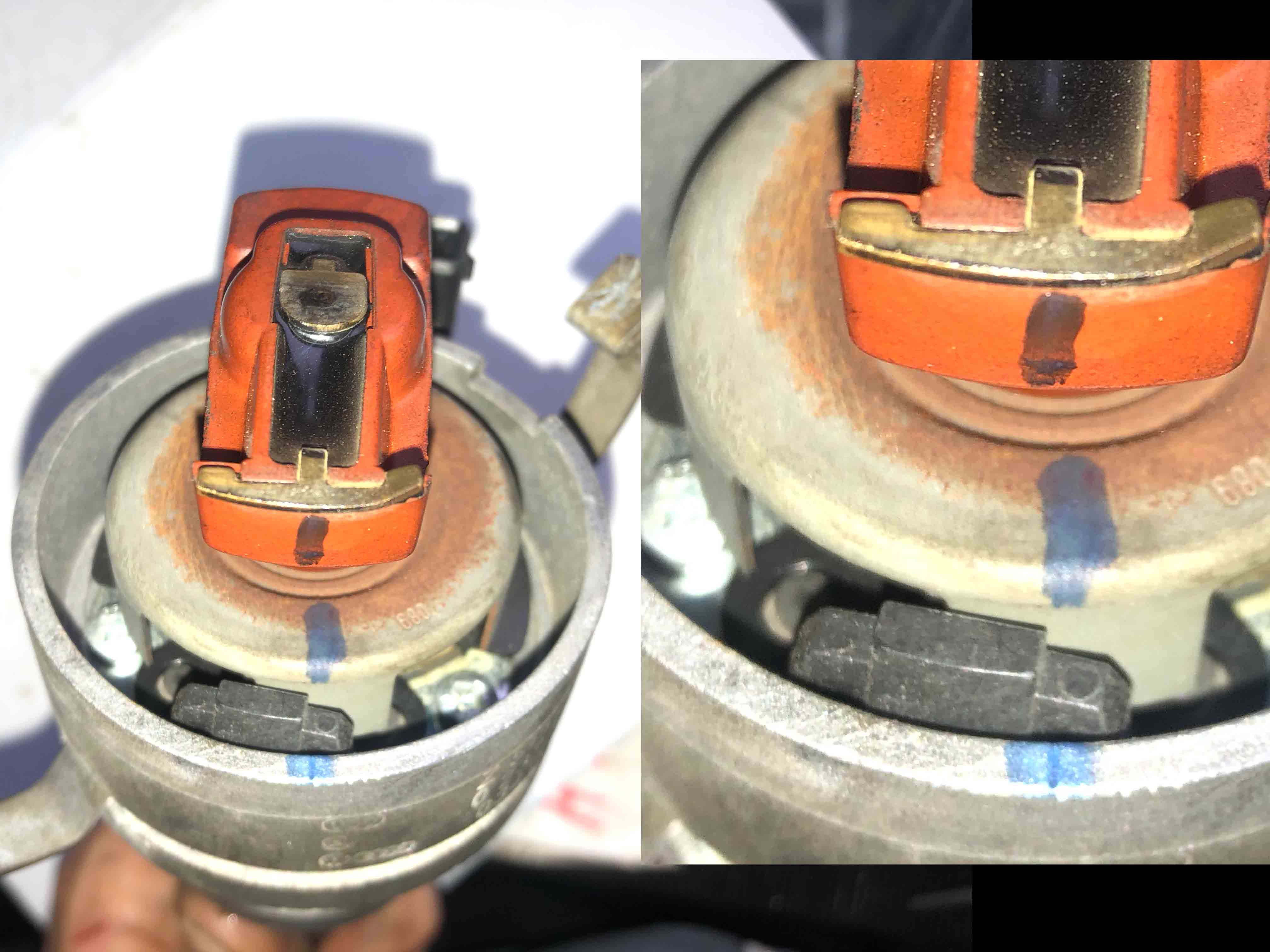

Tosche Paschalusta pasmatriti elsi ja prawilno rastaschil okno at distribyutor.

I am connected via Bluetooth, my OBD-USB Kabel is not working. Please check the Picture if I connected the Kabel correct.
Do I need special software for the Cabel to work?
Please check is I enlarged the window correctly on my Distributor (Photo).

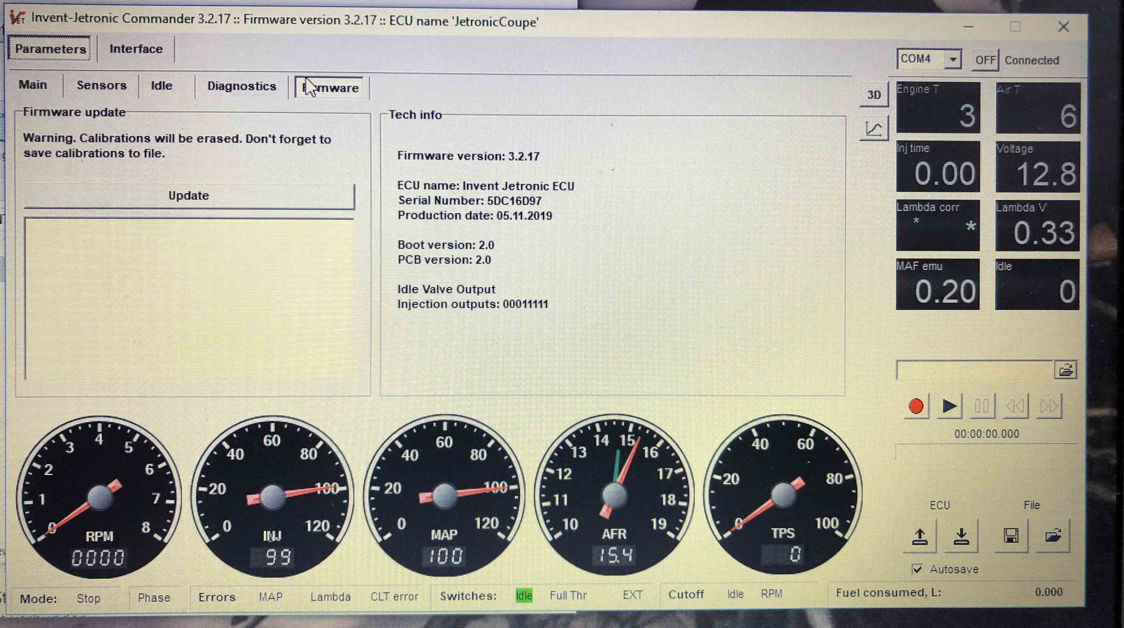

I also tested firmware and Commander Version 3.2.14 everything was the same.

Please Check my Pictures If everything looks OK.
And Please look at the Logs.

I see no problems in log so far. ECU receives good RPM signal, and injection is working.
It seems that shomething went wrong during distributor assembly. You should recheck everything.
Distributor bil Sobrana ni pravilno, on byl pavirnotey na 180 grad.
Maschine tiper sovotitza i rabotayt.

The Distributor was the Problem, it was assembled 180 degree to the wrong position, I rotated it and now the Cat Starts and Works.

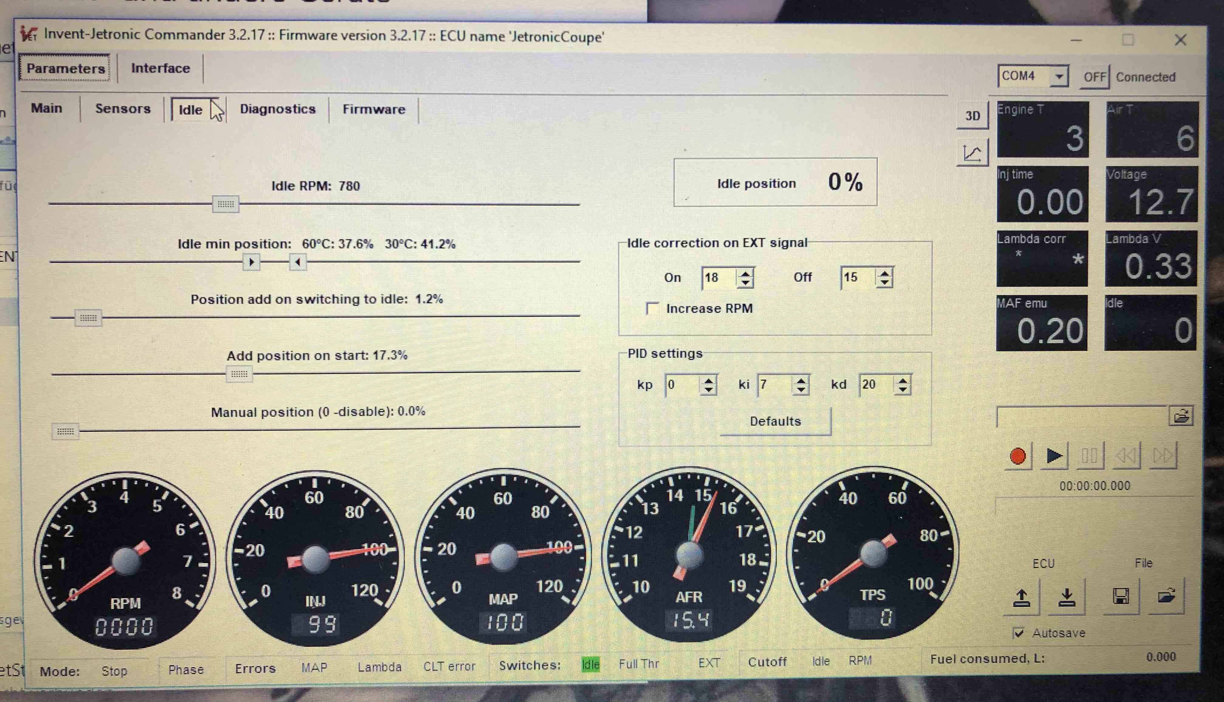

I let the car Idle to temperature today and The RPM are way to high (1800) when I put the Idle valve in "auto" because it goes to 99%.
When I put manual Idle at 40% it works good.
Why is the Idle Valve always going to 100% what is the issue?
See the LOG.
See the LOG.

It is known issue. It points to defective Idle switch. Idle switch is dirty or worn out, and it produces impulses instead of steady signal. It causes wind up of idle position.
You should cleanup or replace idle switch. And recheck it's position.
